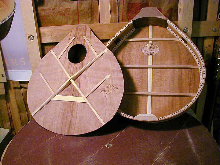

Here's a picture of the insides of one of mine. It's a redwood top, and Koa back and sides. The braces are 1/4", they are tapered.
As long as you don't use too much down-force on the top by using too steep of a neck angle, the tops hold up just fine. I make my bridge 1/2" high without a saddle- and I make it so the fingerboard with a straightedge along it will just meet the top of that bridge. Then adding the saddle will give me the action I want. I use a bridge with a slot for the saddle to sit in and I can use an under-saddle pickup that way.
